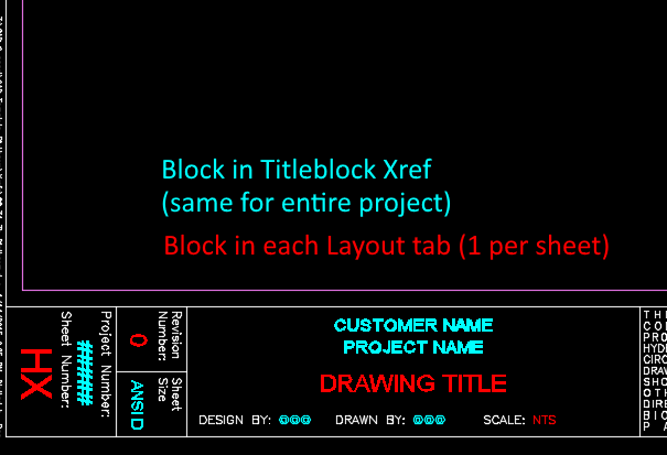

I think this could be avoided if you make your titleblock the way we do.  The titleblock is xrefed into all drawings.
There are 2 blocks:  1 has things like "Project Name, Customer Name, Project Number" which are the same for the entire project.  This block lives in the titleblock xref and all drawings will update if any of those values are changed.
2nd has things like "Sheet Name, Sheet Number, etc." and those values can be changed in each individual sheet.
I think if you set up your titleblock similarly your problem will be solved.
