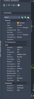

Im sorry Im not very advanced in it. I try to answer rest of questions:
This is text Information:
Mlines are always the same width just length may vary. But length variations doesn''t matter for the text. Text stay always the same size as shown above.
