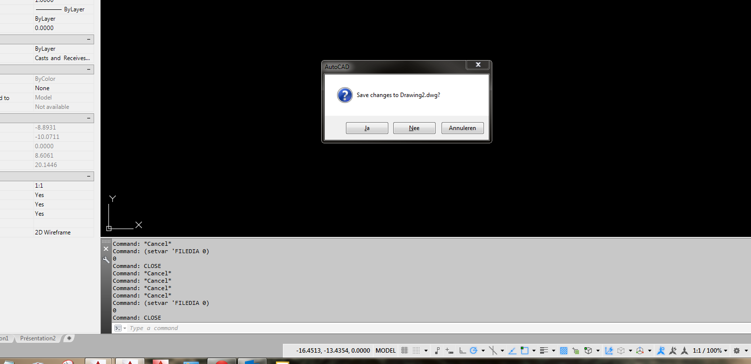

Hi i m working at a lisp to updates blocks from a script. the script is made by a lisp so we can go both directions.
It works fine in autocad, need some safetytriggers in but i will take care of it.
The problem is we have a extension "Architectual structural detailing" that interruping the script. I started this also in ASD forum but don't think i will get a solution there, SO plan B is= Load the script only in Autocad 2015 en not in Architectual strcutural detailing, is this possible?
Link to ASD forum
http://forums.autodesk.com/t5/autocad-structural-detailing/script-open-command-getting-interupted-by...
Edit: first problem solved with working with trusted locations.
Second problem, if you work with script you better set your filedia on 0
But when i hit close in ASD the close warning still popups see attachment.
any way to override this?

Message 2 of 9
hmsilva
Hi Dieter,
Instead of using the command in your script, try (setvar 'FILEDIA 0)
Hope this helps,
Henrique
Message 3 of 9
Henrique,
no luck, it stills pop up with close button
Tried also with a primitief way but also no luck, i tried to launch a ASD command and see what it returns but both nil (autocad and ASD). see below
(defun c:test (/ )
  (if (command "rbctoi" )
    (princ "yes")
    (princ "No")
Message 4 of 9
hmsilva
Try saving the dwg before.
Henrique
Message 5 of 9
Still the same, see attached
if i run AECversion it's the same, ASD has his own RBCTversion command.
Are there any commands for getting info about the program in lisp?
it would be enough if i can define it if it's ASD or Acad.
Thanks.

Message 8 of 9
I m not sure if that will work because they are both above 0. Maybe i can focus me on the workspace? In asd - acad we have different workspaces cause ASD has his own toolbars. So that will always be different.
But that's for this evening, gonna check that + see if i find more autocad-referention.
thanks
Message 9 of 9
I found a solution for this, without using workspaces:
This function will check if it's ASD or not, you can use it as a part of your lisp.
(defun ASDCHECK  (/ LOGFILENAME Count LengthCompare Version)
  (setq LOGFILENAME (getvar "logfilename"))
  (setq Count (vl-string-search "\\autodesk\\autocad" LOGFILENAME))
  (setq LengthCompare (strlen "\\autodesk\\autocad"))
  (setq Version (substr LOGFILENAME (+ (+ LengthCompare Count) 2 ) 10))
  (if (eq Version "structural")
    (setq Version "ASD")
    (setq Version "NOT ASD")
  Version
Outcome is string: "ASD or "NOT ASD"
thanks.
