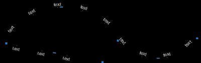

Does anyone know of a lisp to do something like this??
Label multiple 2d or lwpolylines to with aligned readable text at intervals.
A path array (exploded) works but I'd like to label ALL polylines at once.
cheers

Kent1Cooper
Would a linetype with text inclusions work?  They could be raised above the path -- they don't necessarily need to be centered on it as in sample AutoCAD linetypes.  It could include the arrows as well as the text, if their having a more regular relationship is usable for you.  But they would need to be the same color.
For a difference in color between path and text, a MULTILINE Style could be defined, using a linetype that is only the text inclusions.  It would need to at least have points, but they might be able to be buried in the text, or in the path beneath it.

Kent1Cooper
How about one that you can use as a copy in-place of your path object, with a linetype that just has the text inclusions?  This definition:
A,0,-8,["text",STANDARD,x=-1.125,y=.5,s=1,u=0]
does this:
The dots lie along the path, so they get buried when used as follows:
If I have the green path [Polyline] here, Copy that in-place, and change the linetype of one of them, I get this:
So they can be on different Layers, or on the same Layer in different colors, even different linetype scales, or whatever you like.  [The green part is in a linetype I happen to have with arrows -- it can be anything.]  All those differences could be programmed into property assignments in a defined command.
You can play with the spacing vs. height vs. offset from the path, and with the X offset depending on the length of the actual content and style of the text piece.  [It does have what may be a drawback for you, in that it requires a separate linetype definition for every text content you would need.]

_anonandon
like this, i know the text will have to be added separately in the appropriate layer for each line
Message 8 of 24
_anonandon
i think having text as a line on top of the original line in a layer labelled text might be confusing?!

Moshe-A
@_anonandon  hi,
check this METXT command
enjoy
Moshe

Message 11 of 24
_anonandon
thanks, this is great but why reverse some polylines? I need them the same direction!
Message 12 of 24
_anonandon
thanks for metxt 🙂
I'm revisiting this as i've got hundreds of lines to label (i know a linetype is the best answer but I dont make the rules 😞
is there any advice how to revise metxt to select multiple polylines in one go??

Moshe-A
No need to copy & paste just new thread on your name
Message 16 of 24
Moshe-A
@_anonandon ,
my apology i did not notice it is you that open this thread, no need to open new
check this new routine
moshe

Message 17 of 24
_anonandon
even better!
for some reason it doesn't select linetype generation enabled polylines?? but I can work with that

Message 19 of 24
_anonandon
I'm happy with the text on either side of the line.
it would be good if the text labels were made in the current layer, not the line layer
and really good!! if the text was placed in the centre of the line and at intervals from there.
current:
t___t___t___
ideal:
__t___t___t__
rob
