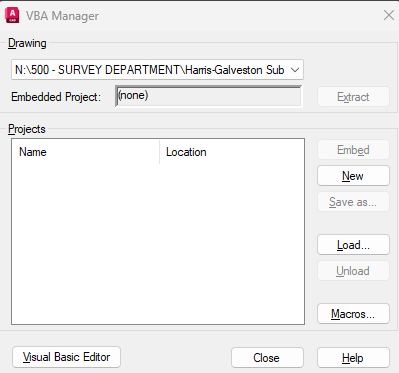

I keep getting this error every time I open my drawings, i have the latest c3d 2024 with 2024 VBA, please advise

Ed__Jobe
What happens if you type VBAMAN?
Ed
How to post your code.
Message 10 of 11
Leo_alhaj
Message 11 of 11
Ed__Jobe
That proves that VBA is actually installed. You may be getting those errors if the dwg has a VBA project embedded in it. But you shouldn't be getting that message. If you open a dwg that produces the error, click on Continue with Current Command to see if the dwg will finish loading. Then run VBAMAN and see if the dwg has a project embedded in it.
