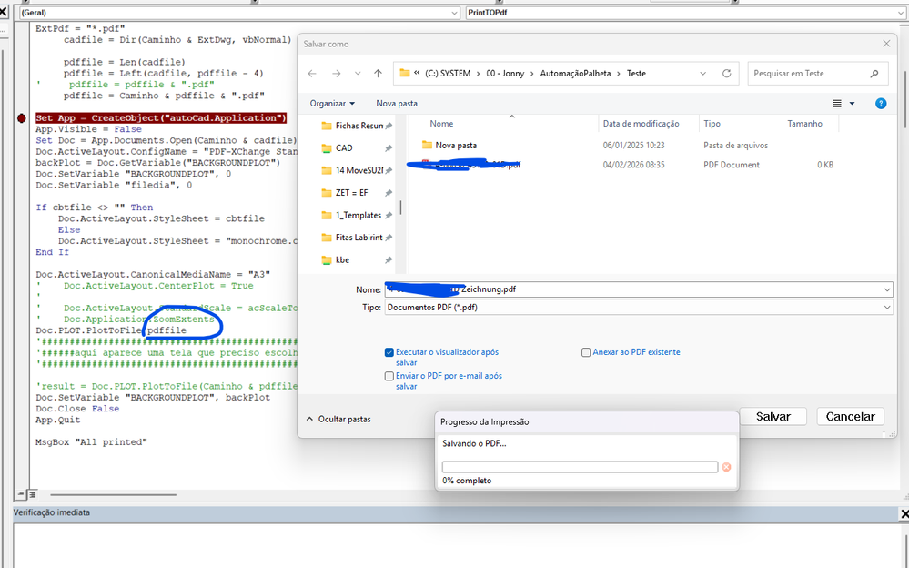

Hi Folks, first off I am not a code guy so please go easy😂
With my small knowlegde I assembled the below code, I got parts from other codes and with my little knowledge I coud get till here i.e. the problem starts on the following line. = > Doc.PLOT.PlotToFile (pdffile)
 at this point a window pops-up to indicate a place and the name of the file, so I want to include in my code the lines for indicate the path and the file name without the system opening this window. Do you know how to do that?

Message 2 of 10
Norman_Yuan
Firstly, please post your code by using the "</>" button in the toolbar of the message window, so that the code's format is kept and easy to read.
As for the code, you may want to firstly give it a try to make this change:
from
to
Doc.PLOT.PlotToFile pdffile

Message 4 of 10
stocjon25
Hi  Norman,
thanks for replying I did what you asked me to do and I got the same result, not has changed.
The window still pops-up requesting file name and local for saving the file.
Regards Jonny
Message 5 of 10
Norman_Yuan
Well, this code works OK inside AutoCAD (i.e. as AutoCAD VBA code):
Option Explicit
Sub PrintTOPdf()
    Dim backPlot As Integer
    Dim result As Boolean
    '' For simplicity, instead of creating an AcadPlogConfiguration object,
    '' make sure the current/active layout is configured to use a PDF
    '' plotting device, such as "Dwg To Pdf.pc3"
    backPlot = ThisDrawing.GetVariable("BACKGROUNDPLOT")
    ThisDrawing.SetVariable "BACKGROUNDPLOT", 0
    On Error Resume Next
    ThisDrawing.Plot.PlotToFile "D:\Temp\Plot Test.pdf"
    If Err.Number <> 0 Then
        MsgBox Err.Number & vbCrLf & Err.Description
    End If
    ThisDrawing.SetVariable "BACKGROUNDPLOT", backPlot
End Sub
So, it seems that your issue may be related to the fact that your code is not AutoCAD VBA code, which you did not specify, maybe from Excel?

Message 6 of 10
stocjon25
Hi Norman,
yes you are right. The VBA Code is triggered from Excel.I thought it was not necessary to mention it.
I need this option from Excel because there are a lot of files to be printed and I wanna avoid to open AutoCAD to do that.
Regards,
Jonny
Message 7 of 10
Norman_Yuan
Well, it is completely misunderstanding that doing this task from Excel side could avoid open AutoCAD: a running AutoCAD instance is still required (evidenced by your code "CreateObject(...)". It is running invisibly because your code did not set its Visible property to true (but AutoCAD instance may still becomes visible for various reasons automatically). Also, each line of code execution from your Excel VBA must communicate to AutoCAD instance across the 2 application processes (Acad and excel), the execution is MUCH MORE slow than the same PDF plotting code being executed in AutoCAD VBA. So, I'd among many possible batch PDF plotting options, doing it from Excel probably is the worse one.
As @Ed__Jobe suggested, using AutoCAD core console would be much preferred/better choice, if you are up to it. If you are limited to use VBA code for some reason, do it from AutoCAD side is desired, IMO. You may want to first retrieve some data from an Excel sheet before starting the PDF exporting, of course.

Message 8 of 10
stocjon25
The reason of doing it inside Excel is because I have a specific task which involves a bunch of code in Excel retrieving some data from other documents, files and even change some AutoCad files generated by another program. So I want to concentrate all codes inside Excel because there I have all piece of tasks that I shall perform i.e. lot o buttons and each button executes one macro, for importing data, converting information, changing title block and so on. Once any person from my department has to perform this piece of work, there in the excel sheet he will have all buttons and just follow the sequence to have the task performed completely. When I meant I dont want to open AutoCad, as I am not a CODE guy I unterstand that I need to open AutoCAD go to certain button and request to run e.g. the code you mentioned and I do not want to do that I just want to have a button for clicking and it will convert all files from a specific folder that I will pick but it will be triggered from Excel.
Message 9 of 10
Ed__Jobe
You can still have a button for plotting in xl, just don't have AutoCAD plot it, use acCoreConsole.exe. From the link I posted previously, the line below is the key part you need. Just have SHELL run it instead of the registry entry that was given.
"\"C:\\Program Files\\Autodesk\\AutoCAD 2026\\accoreconsole.exe\" /i \"%1\" /ld \"C:\\Program Files\\Autodesk\\AutoCAD 2026\\AecBase.dbx\" /p \"<YourProfileHere>\" /product \"C3D\" /language \"en-US\" /s \"C:\\<YourFilePathHere>\\RightClickDwgToPdf.scr\""
