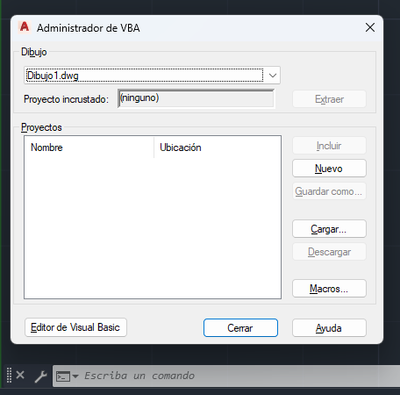

Message 6 of 12
Ed__Jobe
Have you installed VBA for 2021? Open 2021 and enter VBAMAN and see if you get an error. Also, I don't know what AxDbLib is. It should look like the image below.

Message 9 of 12
informatica_riphorsa_com
VBA is installed (the code is working in Excel VBA), only not works with VB6.

Message 10 of 12
Ed__Jobe
Just because you have Excel vba working doesn't mean that you've installed vba for acad. You can test it by entering the VBAMAN command in acad. You will get an error message if it's not installed. It has to be installed for each version of acad that you have. The version of vba for 2019 is different than the version for 2021.
AxDbLib is ObjectDBX
I was expecting to see it named different, as shown in my last picture. Possibly that is just the difference in the Spanish version. They both seem to be pointing to the same tlb file.
Ed

Message 11 of 12
Message 12 of 12
Ed__Jobe
It looks good so far. What program are you using to compile vb6? I know that VBA is at version 7.1. Maybe there is an incompatibility with your vb6 code and vba 7.1 running in acad 2021? Can you use an updated current IDE to compile an exe? Perhaps move to Visual Studio Community edition to create an exe instead of vb6. I haven't used vb6 in probably 20-25 years.
