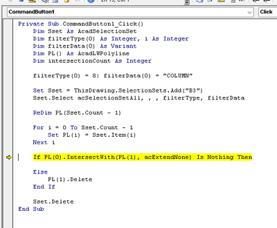

I have this:
I got this code:
Private Sub CommandButton1_Click()
    Dim Sset As AcadSelectionSet
    Dim filterType(0) As Integer, i As Integer
    Dim filterData(0) As Variant
    Dim PL() As AcadLWPolyline
    Dim intersectionCount As Integer
    filterType(0) = 8: filterData(0) = "COLUMN"
    Set Sset = ThisDrawing.SelectionSets.Add("Be")
    Sset.Select acSelectionSetAll, , , filterType, filterData
    ReDim PL(Sset.Count - 1)
    For i = 0 To Sset.Count - 1
        Set PL(i) = Sset.Item(i)
    Next i
    If PL(0).IntersectWith(PL(1), acExtendNone) Is Nothing Then
    Else
        PL(1).Delete
    End If
    Sset.Delete
End Sub

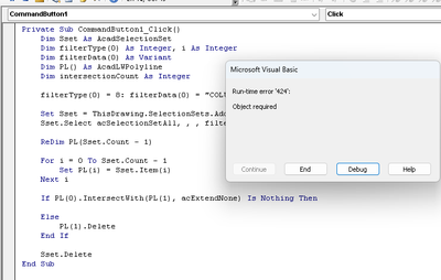

But I have a problem there:
The code doesn't work. Can you help me?

The IntersectWith method doesn't return an Object, so you can't check if it is Nothing. It returns an array of doubles representing the intersection points. x and y. Your If statement could check if the UBOUND of the array is 0.
Note that even if you solve this error, your logic may still not find any intersections at all. For example, suppose that PL(0) is one of the rectangles that don't intersect with anything. Maybe a better approach would be to prompt the user to select polyline1 and then polyline2.
Ed
