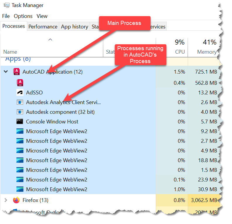

I made a .exe in Visual Studio using COM\Active X. It is a program dialog that the user picks a block to insert, the block gets inserted, then gets rotated. I have it working in VS, but now I want to operate it from autocad at the push of a button. So I copy\paste the .exe from the ...vsproj\bin\debug folder to a trusted location. Then I created and added a command to the menu of our cuix(see below). When I clicked the button it failed(see below). I tried googling my goal as well as the forums\help, but I couldn't find my exact situation or the answer is too complicated. Can you please help me in layman's terms. 🙂

You can't run an exe (out-of-process) file inside AutoCAD's process. You need to change your VS project to a dll project (in-process). Then you use the NETLOAD command to load your dll. Create a command in the dll that you can call from the button macro. It seems that you are missing some basic knowledge on programming. I would pick up a book that teaches Object Oriented Programming, OOP.

No, you don't need to learn asp.net. This search "in-process application vs out-of-process" brought up this article for more info.
If you run TaskManager, you can get an idea about processes. See my screen capture. An EXE creates it's own running process. It can load dll's into it's process, creating another process running within it's own process. AutoCAD has many processes running. However, an exe cannot have another exe running in it's process. Each EXE starts it's own process. They can 'talk' to each other using COM, but your EXE can't run inside acad's EXE.

OOOH! That made more sense then reading about in-process for two hours. Thank you!
