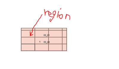

Hi ,
please note code below is partial code and not showing the entire thing hope you still can understand intent
I am trying to convert all AcadRegion objects in selection set to new block
but i am getting nothing not sure what i am missing
for selectedObjects i am getting Count value see screen shot = 20 items
but once i get to line 61 in code "set Blockobj" i am getting error
any idea how to convert/add Region objects to Block

  1. It's the AddRegion method, not the AddSelectionSet method. You need to iterate the selectionset and add the regions one at a time.
  2. You don't need to reference ActiveSelectionSet, just use selectionset1
  3. Your use of error handling needs working on. You need better control of how you use On Error Resume Next. As it is now, it will be masking other possible errors. Read the VBA help topic for the On Error statement
  4. It will help with your error handling if you don't try to put all tasks into one sub. Try to organize your code so that you only do one task in each sub. It will also make troubleshooting easier. If you debug a sub once, you don't need to do it again. For example, put your selectionset creation into a new sub. You can search this forum for my AddSelectionSet function.
  5. Create the new block def first. Then as you iterate the selectionset, you can append it to the block.

norman.yuan
@Ed__Jobe ,
The code would not work: the AddRegion() method requires an array of AcadObject/Entity, not a individual AcadObject/Entity.
@jalal.mousa ,
With AutoCAD VBA/COM API, one cannot add an existing AcadEntity into a block definition (or Model/PaperSpace) via the AcadBlock.AddXXXXX() methods, for example, if you want to add a Line to a block definition, you do not create a Line first and then add it to the block definition via AddLine(). Rather, you pass the information required for creating a line, such as Start/EndPoint, and let the block definition create the entity behind the scene (via AddLine() method). The same applies to AddReagion() method: you DO NOT supply an array of Regions; instead, you pass an array of existing entities (line, polyline, arc... They must all on the same plane, of course) and the AddRegion() method will do the calculation behind the scene to determine how many closed areas these entities would form and then create an array of Regions accordingly.
So, no, your code logic of selecting existing regions and adding them to a block definition does not work. You need find all existing regions' boundary as entities (closed polylines) and then add the array of these polylines with AddRegion() method, and let AutoCAD figures out how many regions could be formed from these closed polylines. However, since there is no way to get the Region's boundary, the logic of adding region(s) to a block definition will not work in VBA/Acad API.
However, if you do AutoCAD .NET API/ObjectARX API, then yes, you can add create an Entity, including Region, first and then add it into a block definition.
