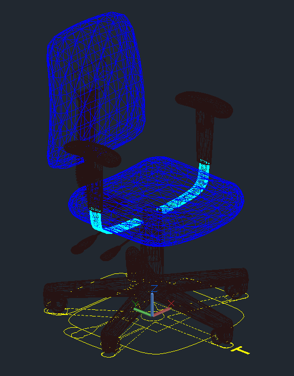

I'm looking the way to project from a 3D model a 2D representation on the floor (as you can see on the image I attached) I'm using Visual Basic on Autocad
The question is:
Does anyone know how to use how to use FLATSHOT on command line in order to avoid the dialog that appears and put the data need it directly on the command line to use it on a script?
for example:
      ThisDrawing.SetVariable "FILEDIA", 0
      ThisDrawing.SendCommand "FLATSHOT" & vbCr & "All" & vbCr & vbCr & "Y" & vbCr
something like that
  or
Does anyone know another way to do it?
Thanks in advance

Solution:
ThisDrawing.SendCommand "FLATSHOT" & vbCr & "0,0" & vbCr & vbCr & vbCr & vbCr & vbCr 'Take the snapshot for flat view
