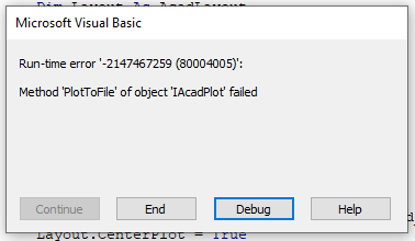

hi all i`m created code with vba to export 10 sheets from model to pdf`s but everytimes had error with line
result = ThisDrawing.Plot.PlotToFile(plotFileName)
can you help me to solve problem?

Have you stepped through the code to see if all the variables are being set as expected? Is the file path really "C:\Users\user\Desktop\autoPDF"? I assume the 'user' is properly set to your profile name?

dasBootik
yeah, this pc have user name - user.
I changed this to
plotFileName = "D:\autopdf\" & i & ".pdf"
and this still don`t working. I also forgot to add scrin error
and after click debug

You may want to try to disable background plotting by setting "BackgroundPlot" system variable to 0 (and restore it back after your coded plotting.
