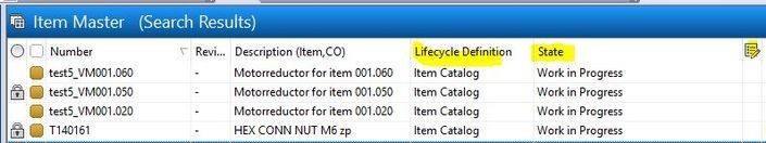

I imported some Items with the Vault Import wizard (2016) by csv, and I noticed that the security was not applied, despite the fact that they have the right lifecycle and status.
Only after changing to another state, then back to Work in Progress the security will be applied (as I've done to test5_VM001.050).
According to Autodesk the security is sometimes not applied to the original import because it is not required or too complicated.
Could the wizard be changed so it will always apply the security associated with the last imported item version's state?
