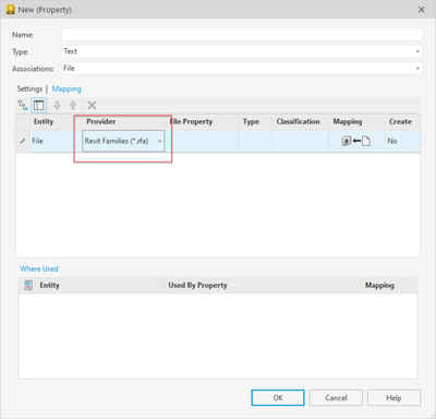

You can already map RFA file properties to Vault User-defined Properties.

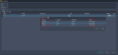

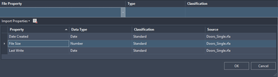

The available properties that can be extracted from RFA files in Vault seem to serve little to no purpose from a data management perspective.
All the rich data that lives in RFA files currently cannot be exposed in Vault's interface.

Thanks for the information. Unfortunately, these items you highlight are not file properties. Revit would have to expose this information as properties that can be extracted before Vault could map them.
Thanks for the clarification @ihayesjr . Ball is in "Revit Idea Forum" court.
