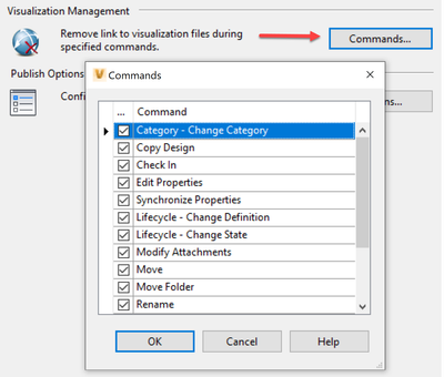

Let's first talk about the DWF file. DWFs are detached during a number of operations because they become outdated. You can see a list of commands that will detach a DWF file from the parent by going to Tools -> Administration -> Vault Settings -> Visualization -> Visualization Management.
This shows all the commands that will detach a DWF file from the parent file. DWFs are not orphaned in this case, they are just not attached to the latest version of the parent file. They are still attached to the earlier version of the file. What you can do is search for files where the "Visualization Attachment" property is "None" and the results indicate all parent files that do not have a DWF file attached. You do this type of search in the Advanced Find dialog and you can choose to search only the latest version of the file.
