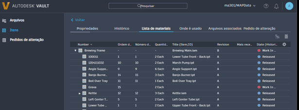

Not a new idea. Autodesk Development Team should bring back the functionality to plot list of files from BOM tab on Autodesk Vault Thin Client 2022.
In Vault Thin Client 2022 plot button is missing in BOM tab. See the below image.
This feature is important to viewer users plot BOM list and be able to copy data from previews plot window to Excel spreadsheet.

It would be even better if the Print view can be customized.
I have some users which need Vault Office Installations for the only reason to print BOMs.

We have the Print option from New Thin Client. Does that help you?

Hello @Senthil_Kumar,
The Print Option allows printing the file, but we were unable to copy the information to paste into an excel spreadsheet. This action is frequently used so they can customize the list.

@marco.coelho  Thanks for that feedback. Got your point.
Senthil_Kumar
This is implemented in 2023.1 Update.
