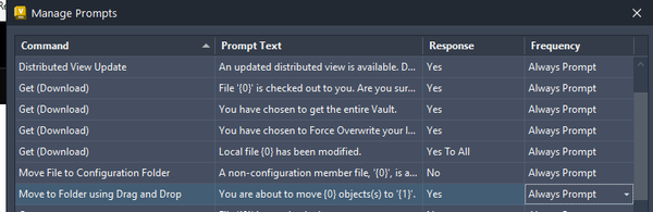

There is also a prompt you could enable to make the user confirming every move action via Drag&Drop if the role solution above is not possible. This should avoid unintendedly dragging and dropping objects:
