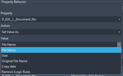

I thought there was an idea for this, but I am unable to find it today - I know Autodesk is aware of it.
It would be great if we could edit the properties of files in the copy design window while doing a copy design. We can view them there - but we are unable to edit.

설계 복사를 할 때, 규칙세트를 작성하려고 합니다. 규칙 조건 빌더를 설정하고 특성 동작을 입력하는데 특성 동작에 대한 값을 사용자가 직접 입력할 수 있거나 좀 더 선택지가 많았으면 합니다.
특성동작에 입력 할 수 있는 값이 한정되어 설계 복사를 하고 나서 또 다른 작업을 해야하는 번거로움이 발생하네요 저만 그런가요?

When using the Vault Copy Design tool, it would be nice if we could have a pre-defined value option in the Property Behaviors section.  When using Vault Lifecycles and Revision schemes, new files need to have a CAD Revision Number that is equal to the default for the Revision Scheme of a file.  A file that is being Copy Designed, may be at a higher revision level than a new file would have so it needs to be set to the default.  Generally, a Blank value is not acceptable so setting it to "Blank" doesn't usually work.  Setting the value to "Reset" doesn't work for files that were originally blank.  During the Copy Design process it would be nice to have the ability to set a pre-defined value so the new files will have the correct default value so the files don't become "non-compliant".  Options would be: In the Action drop-down, add an option for "Set Custom Value" or under the "Set Value As" setting, add an option that would allow a user to type in a value.  Another option would be "Set to Revision Scheme".
In the Action drop-down, the "Set Custom Value" or the "Set Value As" options should be available for all properties, not just the Rev Number property.

We have the same need for something like this. We are using CopyDesign very often and we have some fields which should always be "SET VALUE AS" a custom / admin defined value. Sadly there is no option for this in the Purge:
It should not be a big problem to let us insert a Custom Value here which will always be mapped in the propertie and not only these five pre defined mappings...
