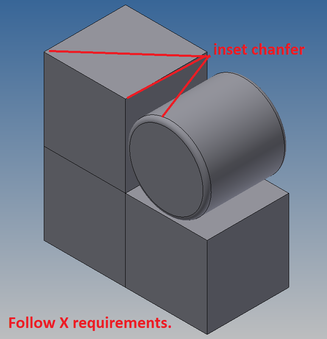

Allow users to paste images when describing lifecycle change, or check in / check out transactions.
This would help users to insert imagens with notes of which places to change.
For instance:
Allow insert of imagens in the following interface:
Thus, users also would be able to link with Standards to help next changes.
As Follow X requirements could have a print of a bending guideline.
Appreciate any support from the community.

Thanks for posting the idea. However, after check in, you can mark up the model in the viewer to record this information.

You could also use Inventor MBD (Model Based Definition) to put in this information.

Could you elaborate more your answer? maybe a video would help how to add notes to a view...

Is Markup available in Vault 2022 version?
ihayesjr
No, that is a feature starting in 2023.
