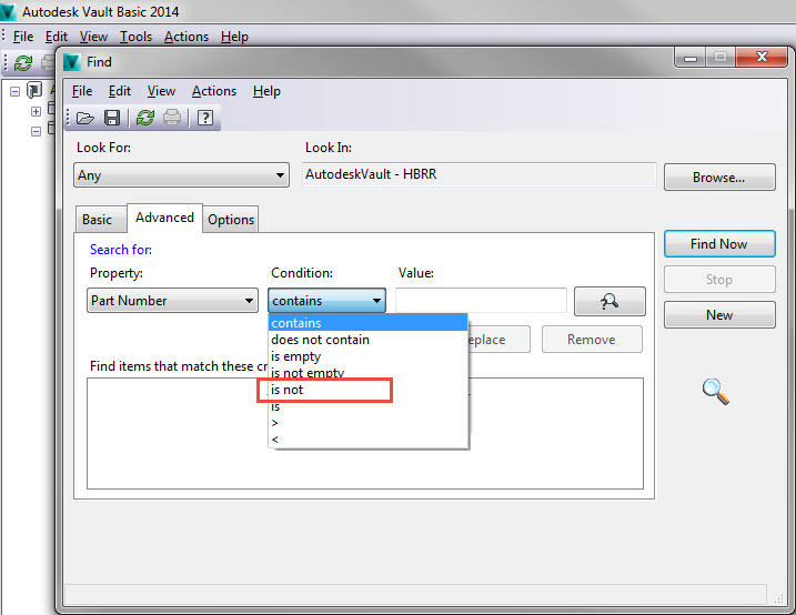

Command FIND, add option "is not" (In Vault Basic)
I have to check the Inventor libraries if the PartNumber of the files in the library are not '_'.
We use this so we can easily reorder out Standard Parts to the top of the BOM in Inventor.
But this option is also very good useable to check if the Projectnumber for al the parts in a project is filled in correct.

Great idea, but how about the 'not equal to' sign:  <>
scottmoyse
These conditions are inconsistent all over Vault. They really shouldn't be. So I'm going to vote for this idea. But not to just add this, but to make the Find & Search experience across the Vault consistent.
This should be a JDI feature. The code is already there elsewhere in Vault, just get this option added and others into the various drop-downs.

Implemented in Vault 2024.1 Update.
