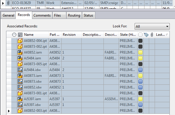

 This frustrating restriction in the system has actually limited the usability for our users. The attached image is an example of a live ECO in our system with 13 files receiving the same change. For our user to right-click and go to folder for each individual file then navigate back to the eco to go to the next number (instead of just right-click and change state) introduces a lot of additional steps and/or manual intervention if they have to manually type each number in project explorer. This is a lot of unnecessary excess work in comparison and this example isn’t the largest of ECOs some have hundreds of files attached.
It seems crazy that calling the same event does not perform the same function?
