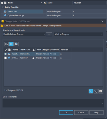

Thank you for posting the idea but Vault already allows the workflow you are requesting.
This image, I think, represents your starting point.
My assembly uses Revision A of the cylinder Bracket which is released, but the bracket is in work in progress at revision B.
I go to change the state of the assembly and this is the dialog you see.
However, when you select the Released State to change to and click OK, another prompt appears.
If you click Yes, the assembly wil get Released and still use Revision A of the part.
Is this what you are looking for?

Thanks for the fast reply. Yes, this works, but most of our users definitely interpret the word "Restriction" in the dialog as a limitation or a reason why the operation is being blocked, rather than as a simple informational message.
This can easily lead to confusion, especially because the Restriction Dialog is initially displayed with the Details section collapsed. Inexperienced users often do not expand the details and therefore assume that an error has occurred and that the state change has been blocked.
In your example shown, the message "File is not the latest" is not actually preventing the state change of the remaining objects. Therefore, the term "Restriction" may be misleading from a user's perspective and could be interpreted as a blocking condition rather than an informational notice.
