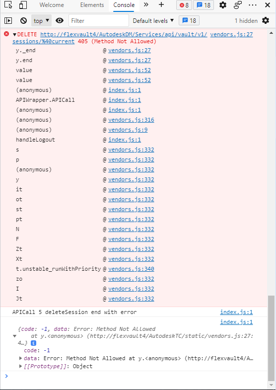

Hi Everyone,
I am using the new Vault 2022 Thin Client, and I find that the Sign Out button is not working for me. It just does not trigger any action. I have tried in chrome and edge, both show the same behavior. I can still log out by deleting the cookie, but this may be difficult to some users.
Does anyone else face this issue?
Is there a quick fix to this? (e.g.: like editing any of the php, css or js files on the server)

2.  Can you please show the Console Window of the browser during log out? We want to see what is the error appearing? You can access the console window in browser using F12 key. You will see the window like below.
3. And here is the workaround for you to log out. Go to Application Tab and select the server address and Storage and click on Clear. That should log out.

joe.corson
Message 11 of 21
joe.corson
@Senthil_Kumar   clicking OK after trying to change admin settingsadminsettingerror2.pngadminsettingerror1.png

Message 14 of 21
Senthil_Kumar
@joe.corson Thanks a lot for sending all the screenshots. One other question. Do you have WebDAV server installed in the same server where ADMS is installed?

Message 18 of 21
Senthil_Kumar
Thanks for confirming it Joe. We suspect that is the one which failing those API calls. We are investigating how to prevent it.
Right now the solution is to remove it if possible. Please check with the Administrator. But we will try to find a solution to keep it ON and also fix the Thin client issue. As soon as we find the fix we will let you know. Thanks again.

joe.corson
@Senthil_Kumar - we will be uninstalling WebDAV in 1 hour. i will update afterwards if it was successful or not.
Message 20 of 21
joe.corson
@Senthil_Kumar - uninstalling it worked for us.
