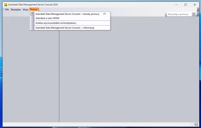

I installed Vault server but I used the Polish installer, now the server has Polish UI. How can I bring it to the default English?
Version 2026.2

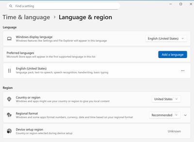

Message 5 of 8
adam_krugG5YNQ
In Windows settings it all seems to be set to English US. Or do you mean some other OS settings?
But the UI for ADMS Console is Polish:

ihayesjr
ok, it looks like you will have to download and install the English version.
