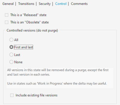

I've tried purging all versions of item "1234" that are in WIP and Design Review. I don't believe lifecycle versions ever made it to "released" state.  I [think] at least one version in a series prevents me from purging entirely, although the parameters for purging to - keep "first and last", have been now been updated to - keep "none", (temporarily). Though purge did not delete any other version.

You need to check the Control setting on the lifecycle state these Items are in.
This controls what can be purged.

Thank you for your assistance... although... I believe what you are referring to was attempted / mentioned in my original post. (i know, long post) sorry.
"I [think] at least one version in a series prevents me from purging entirely, although the parameters for purging to - keep "first and last", have now been updated to - keep "none", (temporarily)."
I don't think they have ever been in a released state, fairly new items, but could they be locked in a lifecycle series that are not able to be purged or deleted?
Farfetched enquiry?
Are the states of lifecycle parameters effective 'pre' lifecycle/state change. Can I update the lifecycle state parameters after a state change and purge previous state based off of current state parameters? I also noticed Category (Historical) may have an effect on this, depending on the Category / Lifecycle / State relationship historically. I verified the item category as well, made sure it was using the same lifecycle definition, with no luck purging or deleting “work in progress” item versions.
Also, if there are multiple lifecycle definitions, each with their own set of 'states' and parameters, is a purge isolated to the part / file and lifecycle / version relationship? I would suspect if separate lifecycle states share the same descriptive like “WIP” or “Work in Progress” it may seem like you are purging “keeping none”, when in reality someone may delete a Lifecycle A Definition “WIP” and leave a Lifecycle B Definition “WIP” untouched.
The only option left at this point, (I believe) due to its low impact on any other documents, was to use a null state lifecycle with no lifecycle states and delete the item entirely. I was able to recreate the item by simply “assigning/updating the item” from the file.
I realize this is not a real solution, but a work around in low impact or early lifecycle workflows. Surely not a recommended standard process, but it worked for this scenario.

No, we don't have an option to go back to reset existing Item versions like we have the option for existing file versions.
