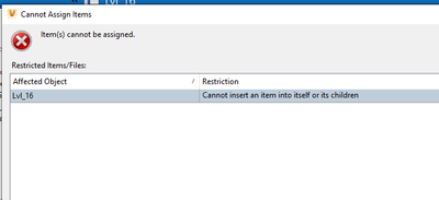

I have created an IAM. file which is a release of units of parts. I then inserted other IAM. files containing the parts of the release. I was hoping to create an Item from this so that I could extract a BOM from the IAM. within the main IAM. but I am getting this error.
I looked into creating the Item by dragging and dropping the individual IAM. files into a new Item form but that would require a lot of searching for the individual IAM.s. Is there something that I can do so that a release IAM. type condition will work?

It’s hard to tell just from these images, but it sounds like there is a circular dependency somewhere in your assembly structure.  For example, does one of the child subassemblies contain a reference to the parent assembly?
For troubleshooting, could you try to recreate this with a smaller assembly that you would not mind sharing in a pack and go?

Is the Lvl_16.ipt somehow a derived assembly still linked to Lvl_16.iam? Maybe that's why.
In Inventor you would get an error trying to include Lvl_16.ipt into Lvl_16.iam, but you may have attached it some other way in Vault:
https://autode.sk/3EErpj7

estringer
The Lvl_16.ipt was created and then placed in to the Lvl_16.iam.
Can you describe how this was created?  That may explain this.

I created the Lvl_16.ipt and imported a DWG of a floor plan into the ipt. I then placed the ipt in the Lvl_16.iam and started using the Joint constraint to place unit assemblies on the floor plan.

D'oh!!  So simple,.... since the part and assembly are the same name, it is trying to create an Item for both.... with the same name.  hence the error.  All I did was to rename the part, and the Assign Item worked.  Thank you for sharing the files, try that and see if it helps.

That worked, thanks again for the help! It seems a little strange that you can't have the same name with different file types. I guess we will have to get a little more creative with our naming conventions!
