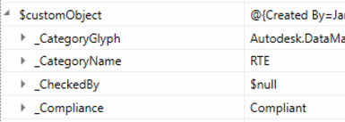

Message 8 of 11
J_Dumont
Hi Markus,
My apologies. That's what I tried first, and I got the same error.
        elseif ($customObject._NewState -eq "Approved" -and $customObject._State -eq "Review"){
            $subject = "An RTE State was Changed: "
            $body = "An RTE was just Approved: " + $RTENumber
            $RTECreatorEmail=mGetCustentPropValue($customObject.Id, "RTE_Creator")
I am able to show I have a value for $CustomObject.Id as shown below.
