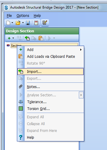

You may find this article helpful.
In ASDB 2016 and 2017 the option is available under the Right Mouse Button

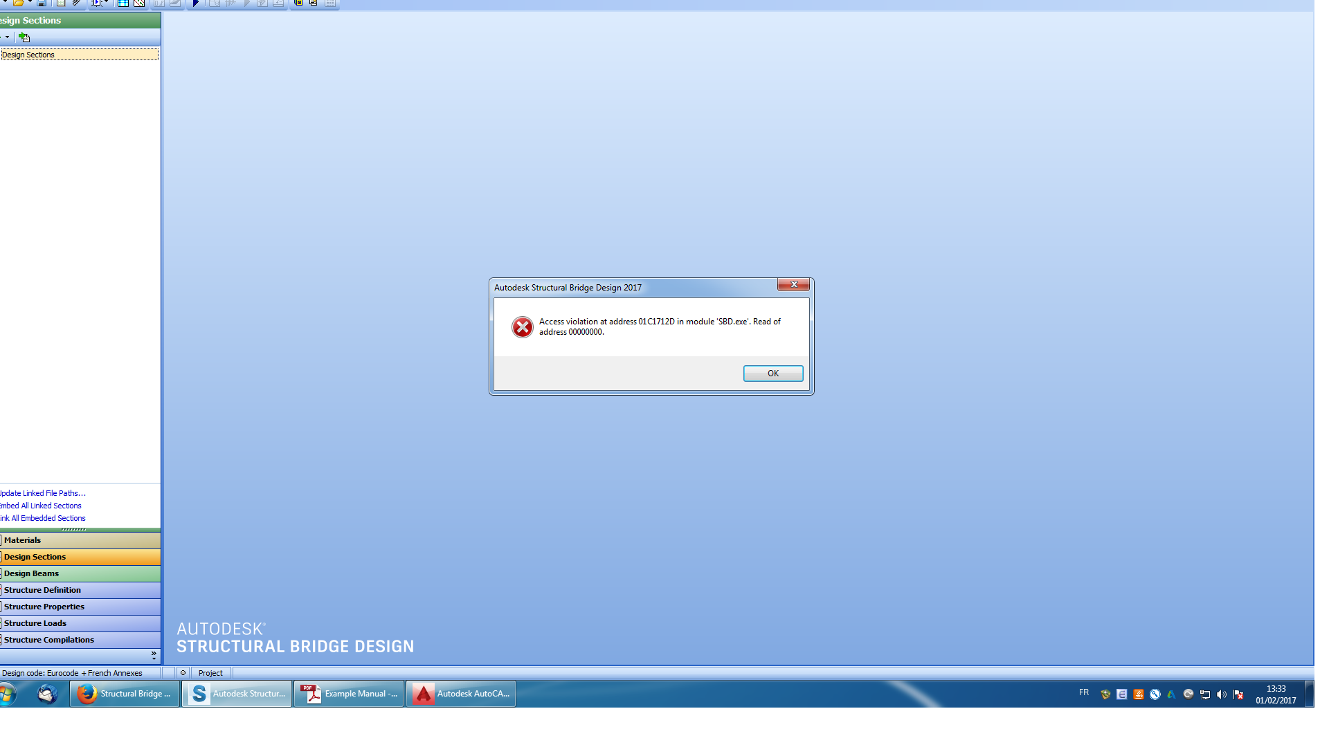

 I tried to follow your suggestion but there is an error. Please see the attached image.
Give me the solution to fix it pls.

When exactly does this happen? When you select the Import option or when you opening the dwg/dxf file?

When I select the insert option

Just to make sure I understand what you mean by Insert correctly. Do you mean that you were able to indicate the dxf/dwg file or this happened when you tried to open the dialog to select this file?

Thank you a lot
I just fixed it.
