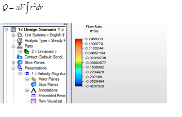

Message 13 of 15
John,
Thanks. I'm on 2011 and don't have some of the features described but got through it. I did get the 6.65 ft^3/s after following your instructions and by inquiring sum on the inlet/outlet surface.
Just a couple more questions and a comment. Does your integral look like the one below? I'm not getting the theoretical answer of 6.81 ft^3/s. And I am guessing the screen scale shown means nothing?
Also, I re-ran the analysis with tets/wedges mesh, the sum on the faces is now 9.60 ft^3/s? Strange!

Sorry. "Theoretical Inlet Flow Rate" shown in my Figure 1 in the previous post would be more accurate if it had read "Hand Calculated Flow Rate". For the inner "circle" of 17 faces, the area is 0.402 ft^2 times a uniform flow rate of 10 ft/s gives 4.02 ft^3/s. Likewise for the outer annulus of faces, I assumed that the flow rate is based on the average velocity (0 at the wall, 10 on the inside of the annulus, giving an average of 5 ft/s). 2.79 ft^3/s + 4.02 ft^3/s = 6.81 ft^3/s. (I calculated by areas by drawing two sketches and "tracing" the inner and annulus areas using construction lines, and then using the software to calculate the cross sectional area of the sketch.)
When I got into the office this morning, the developer explained how my "hand calculation" was too simple. The software is doing a more sophisticated calculation of the average flow rate across the face of a given element. So the "average" flow rate in the annulus is smaller than 5 ft/s, so the flow rate in the annulus is smaller than 2.79 ft^3/s, and the total flow rate is smaller than 6.81 ft^3/s. So the flow rate given by the software, 6.65 ft^3/s, is the correct hand calculation.
The Flow Rate scale shown in the Results environment essentially has no physical meaning IF smoothing is turned on ("Results Options > Smooth Results" in 2011, "Results Contours > Settings > Smooth Results" in 2012). When smoothing is turned off, the flow rate values shown in the legend are the flow through each face of the elements. Thus, you can select the outlet by surface, inquire on the results (the flow through each face), and sum them to get the total flow through the face.
When you say that you created a simulation using tets and wedges, I think you are saying that you created a boundary layer mesh. By making the other annulus of elements smaller, the calculation gets closer to the theoretical result of 10 ft/s over the entire face (just like your integral). So I am not surprised that the new analysis gives 9.60 ft^3/s.
