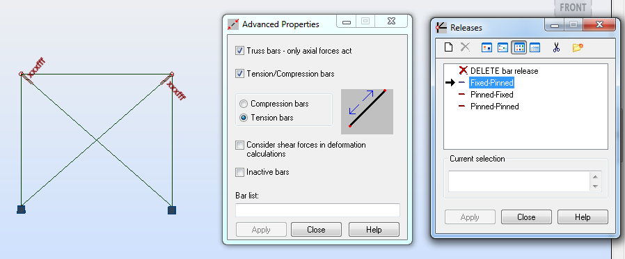

I've been trying to make windcross in a structure I can't really seem to get the hang of it.
I've made the windcross in a fixed frame with rigid corners. The cross is made from two truss/tension bars with Fixed-Pinned releases. When ever I try to calculate I am suggested to use 'DSC algorithm' I've looked through the help file but I can't really figure out what exactly this algorithm does?
Also, is there any way to "seperate" the two bars in the windcross from each other? so they're not joined on the middle, but are able to move seperatly?
- regards Martin

In this case, as these bars are already truss bars (transferring only axial forces), you shouldn't apply releases.
These bars are not joined, so they will be able to move separatly
Truss bars (applies to all tensioned only bars) are by default not capable of transferring bending therefore have 'pinned' ends. No releases should be defined.
Check this part of the help please:
http://docs.autodesk.com/RSA/2012/ENU/filesROBOT/GUID-16BFFEDB-D4E0-496D-B002-C361E21FEF8-254.htm
Also, is there any way to "separate" the two bars in the windcross from each other? so they're not joined on the middle, but are able to move separately?
By default they are not joined. To join them you would need to mark the option I indicated on the attached picture (or create a node at their intersection). You can check if the bars are joined at their intersections displaying numbers of calculation elements after generating the computational model of a structure.

It is only a suggestion rather than a 'must'. The 'standard' approach for modeling releases ('removing of d.o.fs) may in some extreme situations (dynamics, non-linearity) produce inaccurate results (e.g. some bending moment value at releases end of a bar) but not for such types of model. Yet as this is possible (limitation of the method itself) the corresponding information is displayed.

As I wrote previously the reason for this algorithm being available to decide on (in addition to the 'classic' approach for modeling releases) is the fact that is some 'extreme' cases (e.g. non-linear analysis that is 'difficult' to converge plus dynamics) it may produce more accurate results (e.g. eigenfrequences) than the other approach.
In the model you set in Job Preferences the use of the DSC algorithm. If you do so then the 'suggestion' is no longer displayed. You can save such Job Preference as the default one to 'avoid' this message to be displayed but mind that the DSC algorithm has got its limitation - it cannot be used together with offsets (to model e.g. a pinned ended beams under a slab or to generate additional bending on columns due to shear plate connection with beams) and this is one of the reasons it is not set as the default (despite the fact that is some 'extreme' situations it can be more accurate). In addition it doubles the number of nodes at released bar ends.
