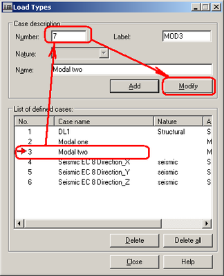

I have to study 2 kind of modal calculation in the same structure.
I created modal rive and modal milieu, which are 2 positions of the same crane. To continue with sismic calculation, how can I assign a modal data to a sismic data?
When i follow with sismic calculation, i get only one output, as in the picture

It will be necessary to renumber one of modal load cases - to define some seismic cases after the first modal and then other seismic  cases  after the second modal load case. Seismic/spectral, harmonic or time history analysis are taking settings from preceding modal load case.
Renumbering can be done here:
After renumbering please remember about checking/updating load to mass conversion for modal load cases.

Many thanks for help
