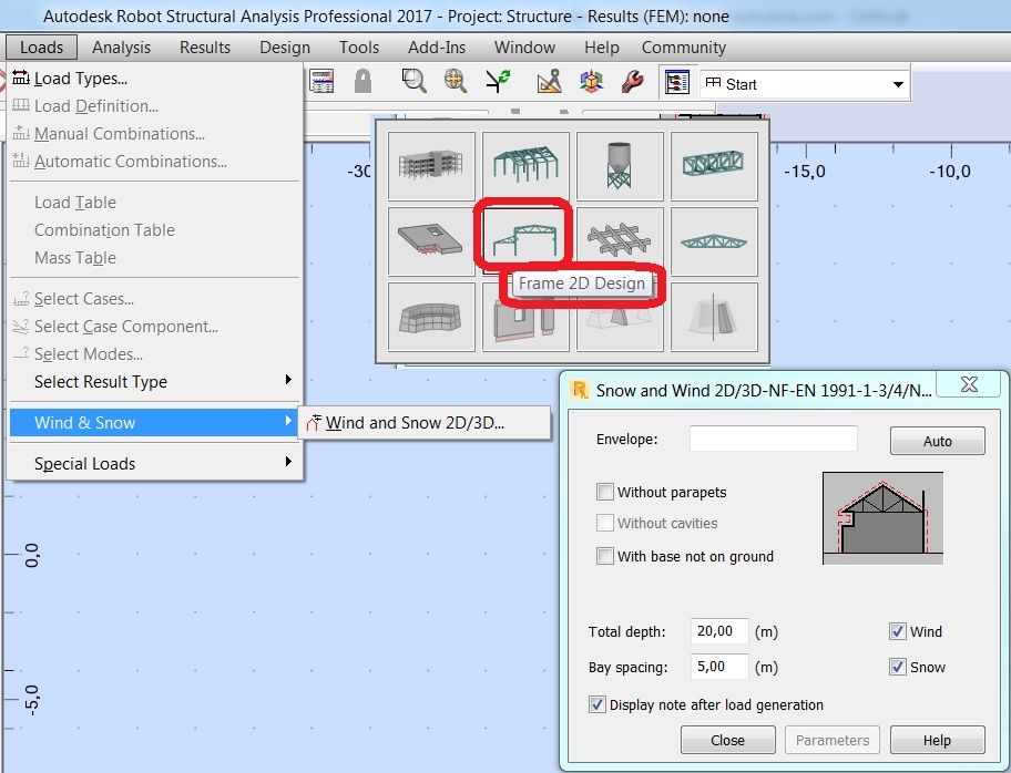

Hello everyone,
i am a new user for Autodesk Robot STR, i was following this tutorial :
https://knowledge.autodesk.com/support/robot-structural-analysis-products/learn-explore/caas/CloudHe...
i did exactly the same steps, but i still cannot select the "Snow/Winds Loads 2D/3D Option" as attached.
am i missing something since i am using the newest 2016 version which is not same as tutorial ?
Any suggestion ?
 Thank you 🙂

Message 2 of 15
napooil
you should select frame 2D structure type.
Message 3 of 15
Thank you for your fast reply, But i already started the whole project in 2D frame
is there a way to re check or re assign the work on 2D frame ? ?
Message 4 of 15
Rafal.Gaweda
Autodesk Support
Autodesk Support
Geometry \ Structure Type -> select 2D Frame
Rafal Gaweda
Message 5 of 15
thank you so much , it helped.

I have the same problem in 3D frame
so I did geometry/ structure type/ 3D frame
and it doesn't change anything as the capture following shows
thank you for helping

Message 8 of 15
I think you made a mistake because this is the link of this conversation here.
Could you answer me if the option wind/load 2D/3D has been defined for the eurocode because It is working for the NV65 but not for NFEN code??
I am modeling under eurocode regulation, when chosing NV65, results are wrong for me.
thank you
Message 9 of 15
Rafal.Gaweda
Autodesk Support
Autodesk Support
Yes it works
Rafal Gaweda
Message 10 of 15
I am on a 3D model
Do I have absolutly to get it through a 2D model?
thank you
Message 11 of 15
Rafal.Gaweda
Autodesk Support
Autodesk Support
There is no such option for 3D models
You have to start from 2D frame

Message 12 of 15
thanks a lot rafal
Message 13 of 15
Rafal,
I'm coming back to you because the generation of wind load in 2D frame are wrong in my model, the cutting zone of wind distribution are not good (but the coefficient and loads are ok)
the automatic defintion of the envelop for the generation is not good (refer to capture), I do something which is not good but I do not know how to correct it.
could you help me again?
thank you
Message 14 of 15
Rafal.Gaweda
Autodesk Support
Autodesk Support
This is not 2D model.
Model must be 2D in ZX plane at Y=0 and Structure Type must be Frame 2D
Rafal Gaweda
Message 15 of 15
I thought it could worked If I selected bars in same planes
