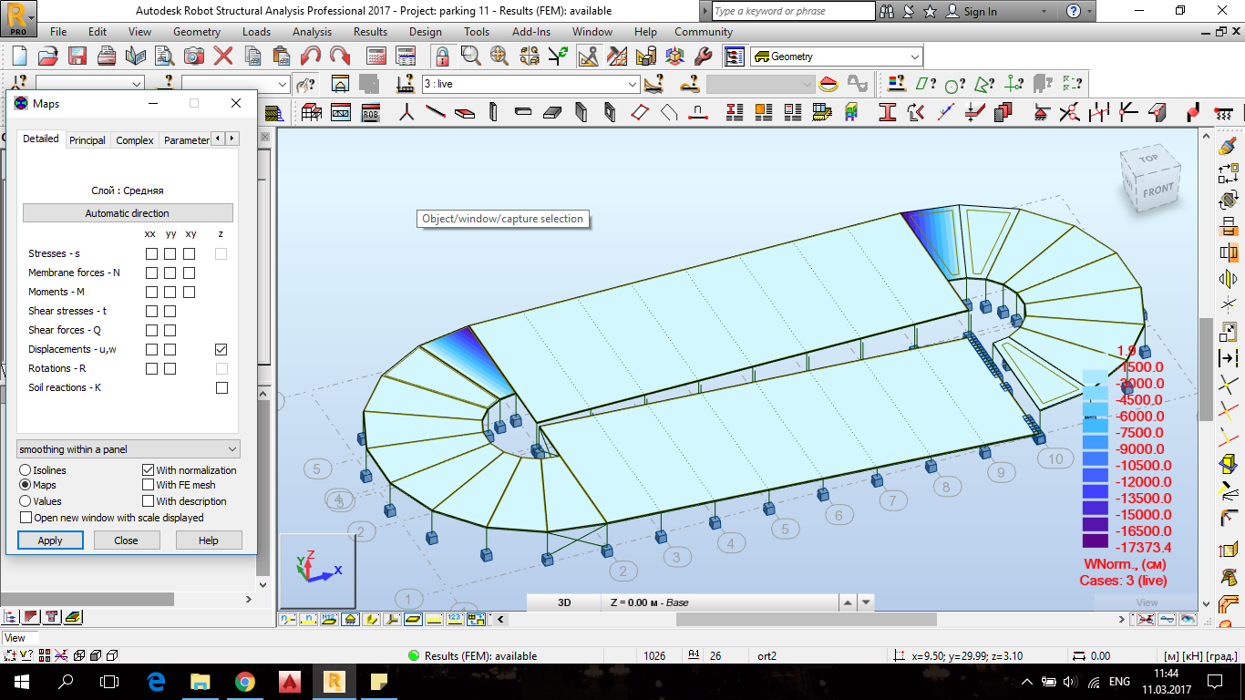

Hello, the problem is that my horizontal slab doesnt connect with the beam and other slab, somehow it has no support,i used contour in nodes, but it doesnt connect..so i got crazy displacesment and wrong maps, i tryed detail correction but it didnt work. I tryed to make unhorizontal slab as well, didnt work. And the other nodes on other slab works ok, and i created it by coping, and somehow they get out of the system.
Please any advise

the problem of not connected panels is because these 2 panels and the large one between them are not in the same level as the others. If you raise the number of decimals ,you will see that they are on Z=3.0985 , while the others are on 3.1000m.
Also many of your beams-slab connecting bars have not the correct Z coordinate(3.1000m) .
There is also some bad meshing spots due to innacurate small connectings bars position.

Also , the positive moment on the slab where you should be expecting a negative one ,is probably due to a "weak " supporting  beam not strong enough to support the slab the way you need/want .
Assign a stronger section to this beam and surely the situation of this slab will improve
