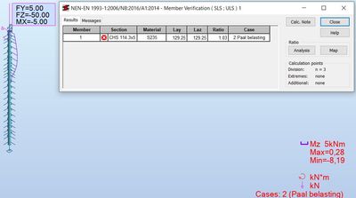

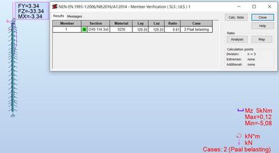

1234eddie
@cool.stuff  thanks for your reply.
i saw i forgot something to mention. I’m only calculating the pile model, and not a complete structure.
See the 3 pictures below which contains the steps i described at the begin of the topic.
1 pile Total load 100kN(FZ), 10kNm due to NEN-EN excentricity, and 10kN horizontal force. Ratio is 2.81.
2 piles Total load 100kN/2=50kN(FZ), 10kNm/2=5kNm due to NEN-EN excentricity, and 10kN/2=5kN horizontal force. Ratio is 1.03.
3 piles Total load 100kN/3=33.34kN(FZ), 10kNm/3=3.34kNm due to NEN-EN excentricity, and 10kN/3=3.34kN horizontal force. Ratio is 0.61.

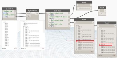

So i went on and started writing a simple script just to figure out how it should work. this is what i have so far.
this is the script inside the python node:
import clr
clr.AddReference('ProtoGeometry')
from Autodesk.DesignScript.Geometry import *
#The inputs to this node will be stored as a list in the IN variables.
Belasting = IN[0]
Aantalpalen = IN[1]
Toelaatbaar = 10
nraantal = len(Aantalpalen)
i = 0
Paalbel = Belasting/Aantalpalen[i]
Unity = Paalbel/Toelaatbaar
Paalbelasting = []
aantal= []
for i in range(len(Aantalpalen)):
	aantal.append(Unity)
	Paalbelasting.append(Paalbel)
#Assign your output to the OUT variable.
OUT = Unity, nraantal, aantal, Paalbelasting
But know i have to add the while function on this so my script will stop wen reaching the ratio/unity of 1. which is as you can see in the picture with 10 piles.
@cool.stuff @Rafal.Gaweda
Does anyone of you know how to write the “while” in this script to get this working?
Thanks in advance
Gr Edward

1234eddie
@Rafal.Gaweda @cool.stuff thanks thank for your replies and thoughts.
I got my script solved.
Here it is. For everyone whos’s using this script(which has in my opinion a lot of potentional) keep in mind that i haven’t used a break function at the end, so if you have a structure where your “Unity” will never reach <1 the script will run forever.
