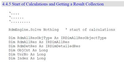

Hi all,
I'm currently working on a script to do the steel verification using the API. Im working with this inside a python schript.
I got some good examples(excel vba) but my script won't work. This is the error i get:
this is what is written inside the API SDK document of the steel design(written for C#)
This is how i have written it in my code:
Line 48  RDmEngine.Solve()
I guess that i'm missing the part which says 'Nothing' but dont know how to write it/how to add it.

I would try this:
RDmEngine.Solve(None)
1234eddie
@JacquesGaudin  thanks for your reply.
i tried your option, but it's gives the same error.
But i found the solution(don't know why it's working).
RDmEngine.Solve(RdmStream)
with this it's running and i  get the results i want.
