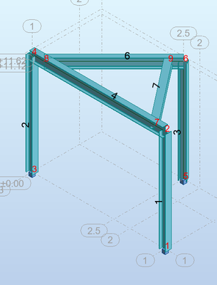

Hello, I am trying to determine how to assign releases to the beams in my model. See attached picture. I have a fixed support at the base of my columns. I want beams 4, 6 & 7 to be fixed-fixed at each end of the beam. How do I do that? I want it to be a fixed structure not pinned. Any help would be appreciated. Thanks

Hi @Wendy_smith
Beams are fixed by default
https://knowledge.autodesk.com/support/robot-structural-analysis-professional/learn-explore/caas/Clo...

Wendy_smith
So, the end release of a beam is already set as fixed? Can you explain what the different checked and unchecked boxes mean? I am new to Robot and cannot seem to find a good tutorial explaining this.

Stephane.kapetanovic
Hi @Wendy_smith
In your case x=fixed, f=free.
For checkbox in dialog box, checked is released, unchecked is fixed.
Releases type for beams pinned-pinned give a release code xxxfff_xxxxff.
If you want fixed ends apply "DELETE bar release" to your beams.

Wendy_smith
Thank you for your reply. Does the same principal apply to columns? Are they presumed fixed as well?
Posts like beams. Be careful, there are supports and releases. To avoid confusion, do not combine the two in same node/end.
