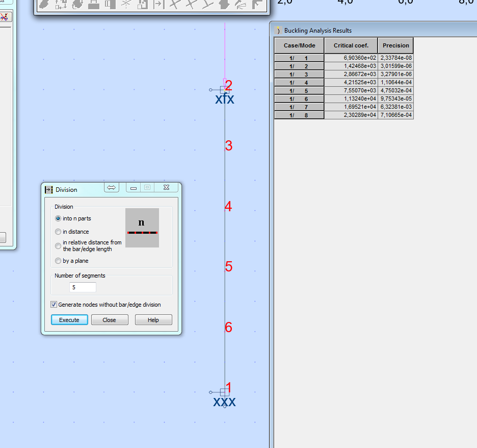

When I was trying to analyze the buckling of a compressed bar, robot structural analysis keeps telling me that there are no elements under compression although there is an element that's compressed. And I have got accurate results when i modeled the same bar in SAP2000.
The example: first Picture.
The model: second picture.
The error: third picture.

Hi @mr.co_su
For such boundary conditions you have to have some nodes defined along the bar element:
I'm attaching the corresponding model too.
If I managed to answer your question(s) press the Accept as Solution button please. This will help other users to find solution(s) much faster. Thank you.

Hello Artur,
I'm struggling with the same problem. In my model of 3D truss construction I have bars which are either tensioned or compressed, there's no doubt about it, but the solver always shows the message "No elements under compression to run buckling analysis".
I have already tried your solution proposed above to divide the bars into more elements and increase calculation nodes, but it seems to not work in my case - I keep receiving the same error message all the time.
I'm running out of ideas what could be the reason?...

Simau
Hi @mgDDJJW
There is no load in case DL2, add selfweight
M. Agayr
Message 9 of 9
mgDDJJW
Gosh, how can be so blind?....Smiley Frustrated
Many thanks @Simau
