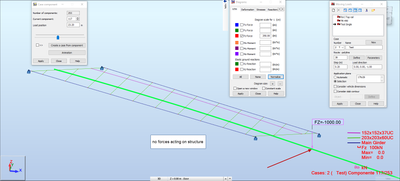

Hi All,
I am modelling a skew rail deck and because I was having a different results than the expected I did a simulation with single-point loading moving through the structure and what I noticed was that I got reactions and result even with the load outside the structure.
Is there any explanation for that ? and what I can do to avoid that ?
Many thanks!

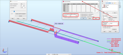

On the moving load dialog window , click on the parameters button and pay attention specially to the tolerance field (click on help button to have a full explanation about it).
Also pay attention to "application plane" on main window . Use selection to select the bars you want to be loaded only.
I selected the bars beneath the route line and set a huge tolerance so only concentrated loads would be applied to my selected bars.
Read all the moving load help section . Many good advices

c.saouridis
Thanks to all, we had the same problem with route extending outside the bridge and we have solved it by following the instructions. It seems that the software does not recognize a load when it is found outside the bridge deck (on the ground) and the way to overcome this is to give a huge tolerance in the Parameters window.
