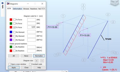

So im calculating truss connection for my masters thesis.When i wanted to check results i obtained note that shear forces wasn't used,and the connection was treated like truss node connection.What does it mean. I see other softare takes shear forces into consideration.

Can you translate the annotation into English.
Otherwise in truss type there is only tension or compression
