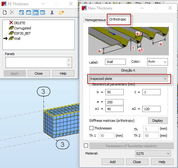

I'm currently trying to model some shipping containers of various sizes and I'm struggling to model the walls correctly.
I've tried to model them as diaphragms but I get the attached jpeg warning; 'Incorrect panel calculation model'
I'm not entirely sure which panel calculation model to use to effectively model the walls as structural elements.

On calculation model dialog , flexible diaphragm is only for panels in XY plane. If you really want to model a vertical diaphragm , you would have to do it yourself using rigid links .
But anyway , for this model it would be impossible because of the common edges nodes that would become slave node for both panels(vertical and horizontal) , which cannot be done!!
Instead ,change the model to "shell" calculation model , and there will not be problems.
Also
1- What are those bars on the containers base?
2- Not a specialist on containers , but wouldn´t be more like this below ,instead of 3mm constant thickness?
3- changed the mesh size to 500mm to get a much better mesh.
Model attached
