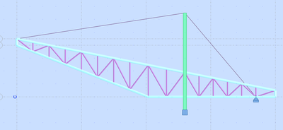

Attached is a cross-section of a proposed cantilever roof section. I aim to support the end with a cable that extends over a central pier to the other side. How can I model the cable so that the tension is equal on both sides? Is there a way to model a pulley support at the top of the pier?

Using "truss bars" type instead  of cables ,You can force the horizontal component of the 2 " cables" to be the same by setting a shear release on the mast top in the same plane of the mast and the 2 cables..
If the mast local axes are not aligned with the cable directions then you will have to adjust it with Geometry/properties/ gama angle

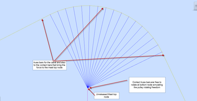

In fact there is a way to to do it!!!
I changed the structure type on Geometry menu to Frame 2d to avoid unecessary instability warnings on non relevant directions to this model.
Then I edited the mast top geometry to simulate the cable around a pulley device . Cable angles became slightly different in this process ,compared to the original model
Everything was done with truss bars
Unreleased model would be the most common choice for this type of structure
Mast top node released for shear , my 1st suggestion  has the strongest point ,as a side effect, making the mast moment Zero all the way to the bottom as there is no shear on mast top. Mast axial force are way higher though.
But I think it would be hard to build that shear release on real life.
Pulley system , good exercise , but in this case/model geometry ,I don´t see much difference compared to standard model . And never saw that also in real life.
