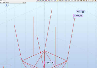

I have a very simple structure in Robot. I added in a few levels  and axis definitions for x, y an z.  I added members until the second gridline (z direction).  When I try to snap to gridlines above 2 (3 and 4), it does not snap to it.  (see the attached pictures).  It does not matter how I try to connect the member, it would not snap to level 3 and 4.
Any suggestion?

Select any of the planes (XY , XZ , YZ)  and see if it works on them instead of 3d

On the planes it works, but not on 3D.  NOt sure why though

Hi Even have beams and cannot snap to the ends of them??

To snap to the nodes click here
