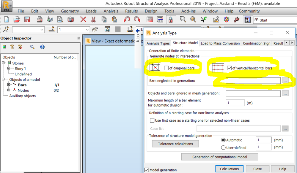

Hi there,
I was wondering if it makes any difference if a beam is modelled continuous with intermediate beams intersecting at nodes. In my case, beam 212 is continuous with beams 69 and 26 intersecting at midspan. In reality, beam 212 will be continuous i.e. a primary beam with 26 being the incoming secondary beam.
Is this the right way to model it or should I be splitting beam 212 into 2 beams with no releases? I have tested it both ways and the results are identical however, I wanted to make sure that there was nothing happening in the background that I should be aware of as some softwares require members to be split at all nodes.
Thanks!

In your case there will be no difference if you consider static analysis results only
If side beams are connected with main beam in node lying on continuous element, Robot divides main beam internally, and forces are transferred properly. Internal division is always done when node is defined in intersection point.
Differences can be in design modules
If you are going to design main beam (steel module) deflection, buckling length, lateral buckling will  be defined in respect to its total length.
In Analysis> Analysis type >  Structure model tab you can find options for intersected bars (when there is no node in intersection point defined - 2 continuous beam s intersects each other)
There are 3 options
- automatic force transfer for bars parallel to global axis  (default)
- automatic force transfer for bars defined in arbitrary direction - diagonal (can be check on)
- manual exclusion selected bars (by numbers selection) from forces transfer when they intersect with other  bars (neglected in generation)
