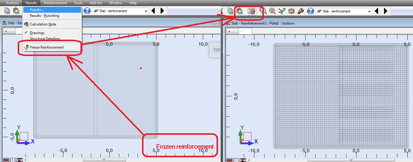

Hi all
I have two problems regarding slab reinforcement.
When I manually set provided reinforcement as I wish (The set reinforcemnt seems OK, because provided reinforcement area is larger than required reinforcement area), Robot doesn' take it into account. Calculation errors an reinforcement display are attached.
The other question is how can I manually set provided reinforcement with wire fabrics instead of reinforcement bars?
Thanks in advance.

I guess you have frozen reinforcement before dleting it.
Rafal Gaweda
Message 5 of 13
You're right. Thank you.
Message 6 of 13
How can I know that reinforcement are frozen?

Hi Rafal,
Similar to what's been discussed in this thread, I've manually drawn the reinforcement on a slab. However I can't get it to appear in the 'Slab -reinforcement' module or the Final Drawings; they both show the slab without reinforcement.
On previous slabs when I have automatically calculated the reinforcement in the provided reinforcement module then the reinforcement shows in the Final Drawings and the 'Slab - reinforcement' modules once its been calculated...
I have frozen the reinforcement, possibly before I pressed the calculate button, so my questions are: is this the reason that it isn't working? And if so how do I unfreeze the reinforcment? In the Results menu it only has freeze reinforcement, not unfreeze and freezing it twice doesn't seem to unfreeze it.
Matt
Message 9 of 13
I should also add that I don't appear to have the reinforcement freeze icon/button in the toolbar as you show in message 7. But it says in the Calculation errors list and the Slab-reinforcement module as in message 4 that the reinforcement is frozen

https://www.dropbox.com/s/6q3pedtm47rgzcs/Robot%20Slab%2018.9.14.rtd?dl=0
I apologies for the large file size. I know it ought to be opened in repair mode to compress it but I didn't want to lose the reinforcement.
And the calculation errors are due to a collegue creating the model 🙂 but that shouldn't affect this I don't think.
The button to unfreeze the reinforcement is in the correct place in the Slab-reinforcement module when the file has been created in Building Design but not when it has been created in Plate Design which is what this model was made in.

Unfreeze slab first
