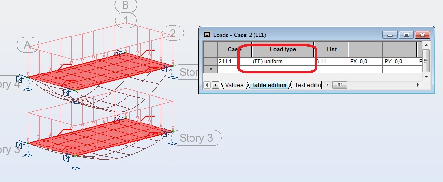

I am analysing concrete slab supported by two metal beams.
I have created test model with 4 storeys:
Story 4 - concrete slab + metal beams without offset
Story 3 - concrete slab + metal beams with offset
Story 2 - cladding + metal beams without offset
Story 1 - cladding + metal beams with offset
Problems I have:
1. Storyes 3 and 4 - slabs do not transfer load.
2. Story 1 - How to avoid moments over supports.
Can you help me with this?
Wrong load type - must be any (FE)... load
