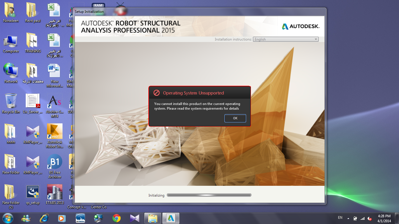

Dear sir
i upgraded my PC RAM to 8GB and when i install i get this message ( attached files)
Best Regards
Message 6 of 19
I did what you said and i upgraded to 8 GB but no result .

BTW - system requirement is W7 SP1, you have W7 only.
Upgrade your windows system.

Artur.Kosakowski
Autodesk Support
Autodesk Support
MInd that for Robot 2015 you have to have SP1 for W7 installed. Only 64-bit OS are supported. XP is not supported.

Hi Rafal , thanks for your help , RSA 2015 Trail version is now installed Robot2015.png
