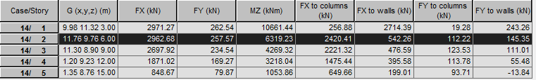

Hello everyone,
I am trying to determine the structural type of my structure in each directions X and Y by calculating the percentage of base shear resisted by walls and columns. This will allow me then to determine the behaviour factor q for ech diretion of the structure.
This is the procedure i followed.
1. Defined modal analysis parameters
2. Applied a seismic analysis using the elastic response spectrum (behaviour factor q not yet calculated) in deirections X and Y
3. Then i viewed the results from
Tables -> Stories -> Reduced Forces -> for case Seismic EC 8 Direction X (see picture below) -> Story 2 results
As you can see from the results Fx to columns is 2420.41 kN
4. In order to double check this value i checked the Fx value on each individual column using the Results -> Diagrams -> NTM -> Fx Force (see the picture below) for case Seismic EC 8 Direction X  SRSS
When i sum up the max Fy on each column the total is 3085.77 kN which is nowhere close to results given by the Stories Table results.
So why does this occur?

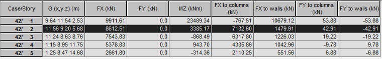

In order to further check the results i decided to apply an Equivalent Lateral Force Method Analysis in order to determine the percentage of base shear resisted by walls and columns.
Here are the results
Tables -> Stories -> Reduced Forces -> for case ELFM in Direction X (see picture below) -> Story 2 results
As you can see from the results Fx to columns is 7132.60 kN
4. In order to double check this value i checked the Fx value on each individual column as i did with the Elastic Resppnse Spectrum using the Results -> Diagrams -> NTM -> Fx Force (see the picture below) for case Seismic EC 8 Direction X
When i sum up the maximum force Fx on each column the total is 8380.86 kN which is nowhere close to results given by the Stories Table results.
Any suggestions? I would really like to hear how each one calculates their base shear so as to decide the type of structural system.

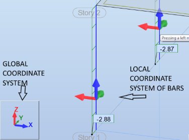

Bar diagramms are refered to local coordinate system of bars
The reduced forces of the story table are refered to global coordinate system
So in your case FX of story table is an orizzontal force (shear) but FX on the diagramms NTM is the axial force (N).
(And FY and FZ are the shear (T) forces on bar diagramms)
So if you want to compare the results you have to compare FX of stories with FZ (or FY depending on bar coordinate system orientation) of diagrams for case EC 8 Direction X
I hope it's clear

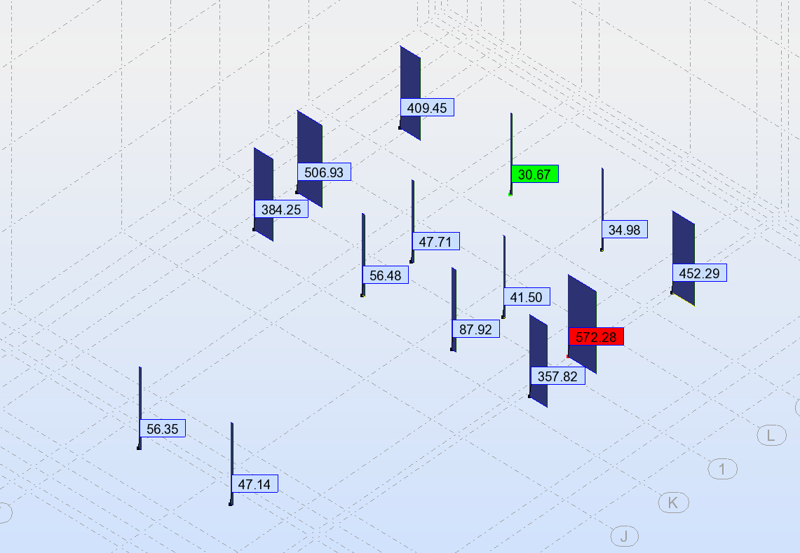

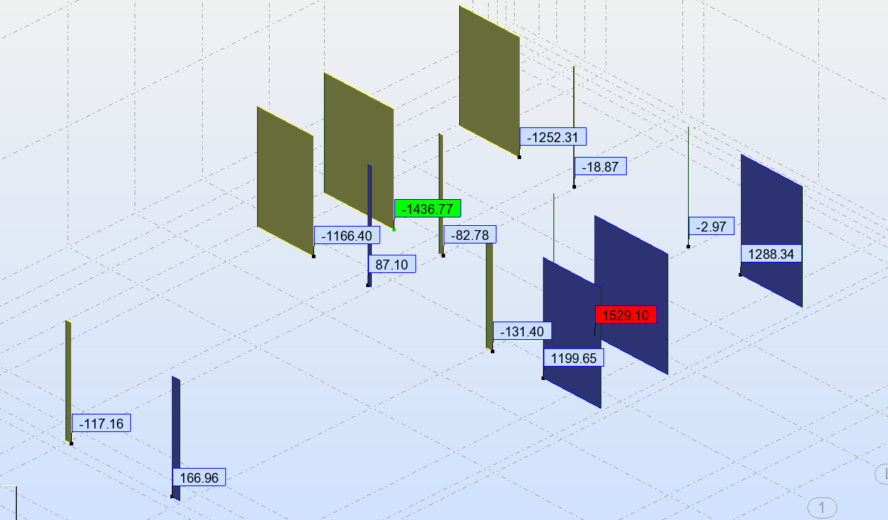

Hello dimogrec, I have followed your advice and now i get exactly the same resutls between the local analysis results on bars and global reduced values table.
Up to now i was able to compare the analysis results (shear force) of the columns but i cant figure out how to get the shear force results of the shear walls? I have tried the Results->Maps-> shear force but the results dont make any sense when compared to the reduced forces table (FX to walls).
Can you please help me figure out how to get the shear force of the shear walls so that i can compare it with the reduced force table results, like i did with the columns

I suppose you are using walls with FE
In this case to compare the results you have to define core walls.
if you have a single wall somewhere in your building click on "Core walls" icon and add your wall as shown in the picture.
Do the same for any wall. Not all together in a single core 🙂
if you have a complex of walls (shape L or real core) you can decide to add all walls in a single core wall or separately as described above
After finishing defining the core walls go to Results->diagramms for buildings->Core walls  and Fy or Fx (this time the results follow the global coordinate system 😉 )
