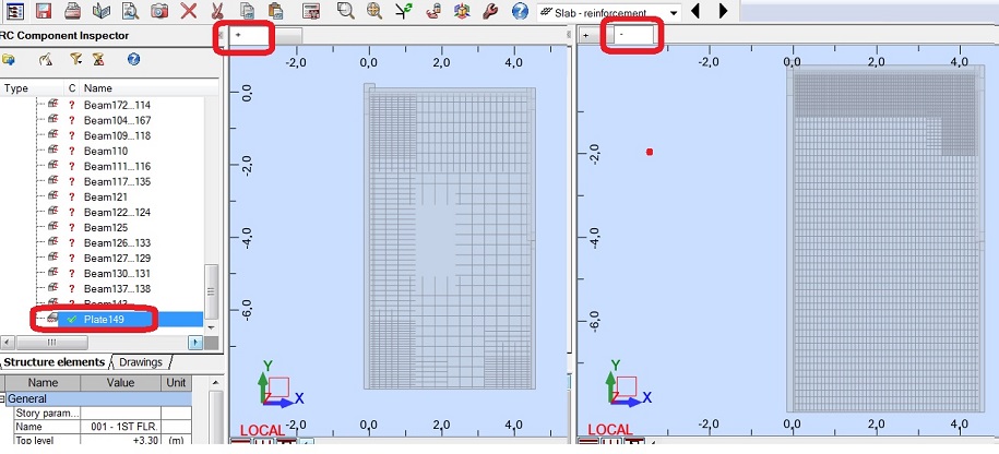

Good morning,
I have prepared a simple model, performed As required and then As provided in the x direction bottom.  That all seems to work.  I then select "slab - reinforcement" and when I change between + and - I can only see the top steel in the graphic, no bottom steel, even though in the table, my manual x direction reinforcement is listed correctly.  Any ideas please?
Thank you
Chris

On Slab-Reinforcement layout select correct display additionally

Rafal.Gaweda
Autodesk Support
Autodesk Support
I do not see any issue
Example for panel 149
Rafal Gaweda
