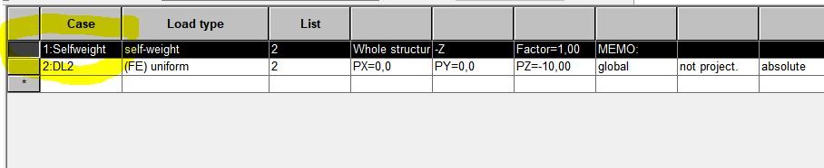

I have set up a FRF case in Robot 2020 and run it.  When I do it without damping I get spikes at the natural frequencies but when I run with the actual 2% damping I get no results.  How do I resolve this?

Here is the file @Krzysztof_Wasik

You have not defined any loads  for FRF load case. Loads are defined for cases 1 and 3 onlyfrf.JPG
