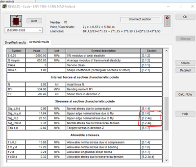

Hello! these links above doesn't work anymore? I have similar problem as the owner of this thread. I want to know how are these three stresses calculated in robot:
where is the section referring? Can't find it on the eurocode 5 ...
BR,
Nikolas
